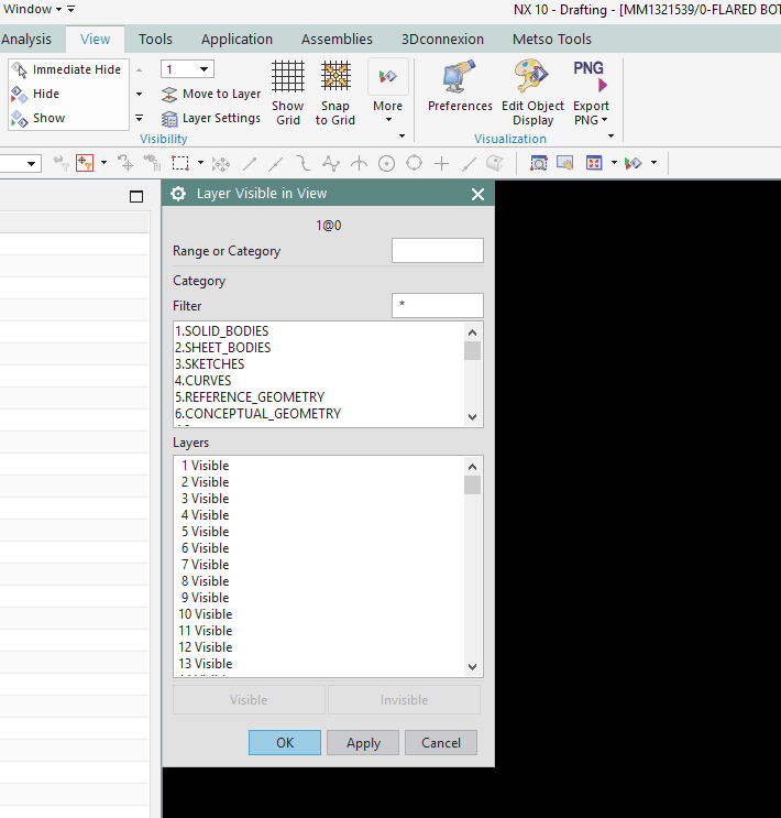

Hi Friends,
I have a simple part, no further references and wanted to create a drawing with 3 views and an ISO view. I must have accidentally pressed any key. I get in the drawing views only a placeholder and can not find the cause.
Attached is an image.

Use your Command Finder to locate LAYER VISIBLE IN VIEW
then follow the command dialog on your screen to set what layers need to be visible in that view.
Or
Before the view is put down on the drawing make sure the layers are set to visible and selectable in your layer menu

Are you using the correct reference set for your drawing? Try setting it to Entire Part
