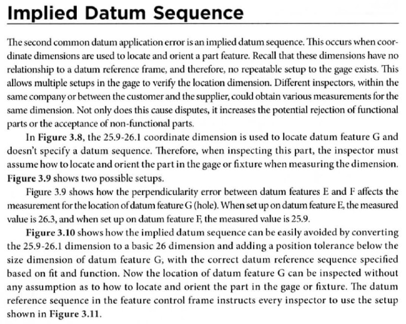

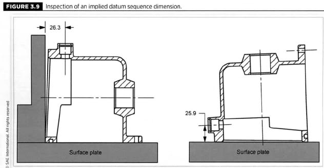

This figure is dealing with the implied datum sequence instead of the gage size, but I can't figure out how to get this MMB gage pin size 120 on the figure posted, I will say it would be 120.10 from the existing data, Please let me know if I am wrong. Thank you.
Season
Thanks for the verification. Burunduk.
Season
I am also not sure what the 25.9 dimension represents.
It should be the one before revising from 25.9~26.1 to basic dimension 26.
Season
May I ask what means implied datum sequence? I never heard this term within Y14.5.
Where is this picture from? Some training material?

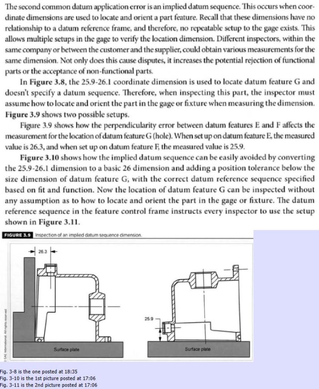

aniiben
Please read the snapshot for details.
Fig. 3-8 is the one posted at 18:35
Fig. 3-10 is the 1st picture posted at 17:06
Fig. 3-11 is the 2nd picture posted at 17:06
All these pictures are from Advanced Concepts of GD&T 2009 by SAE, please advise if the posts is against the copyright and I will remove them right away.

I think I've seen Implied Datum Sequence term used in one of the Alex Krulikowsi's books (Fundamentals or Advanced),not positive thus, but the common denominator was the same: ambiguous setup if ± is used to locate features.
I don't think it's a standardized term, but good to know.
