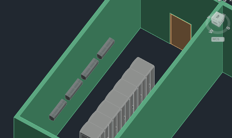

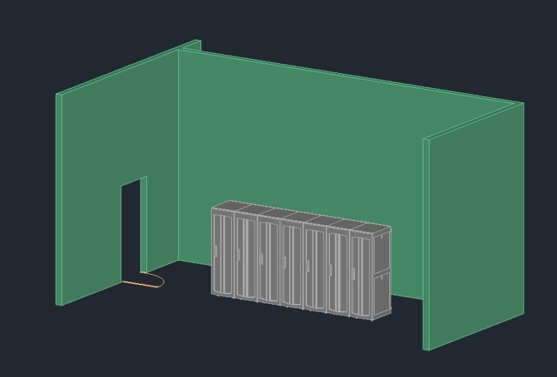

Excellent point about cassettes directly overhead the server cabinets dBill. I was already rethinking things a bit. I was wanting 4 tons units and so far I see most high wall air handlers stop at 3 ton. This might give you some scale to my project, there will be a lay-in ceiling at around 10':
The server cabinets will actually be open front and back and I was thinking distributing the air along the front of the cabinets. Thoughts?? This thread has been an excellent guide for me and I appreciate everyone's help.
You probably looked into this... but for any DX solution you have to consider refrigerant line length limits. Sounds easy to just put an evaporator unit into a closet (after you figured out where to pump condensate). But in reasonably large buildings you find out the nearest possible condenser location is far away.
And yes to the above, don't put anything that ever could have water inside or outside above the racks.
Yep, the condenser is 50' straight up on the roof.
That is getting to be borderline needing floor mounted CRAC unit. From my experience, I'd say you're looking at closer to 10+ tons.
Depending on how critical the servers are, having n+1 redundancy (minimum 2 CRAC units) may be needed, talk with users to confirm.
What kind of flooring is there? If raised floor, have CRAC unit blow down to under flow (maybe some ducting to the racks) and return air from the top of the CRAC units. Space depending of course, need to coordinate with server provider and architect.
Lengths of refrigeration lines on Dx equipment is something to keep in mind, but even the smallest units have limits of 100-125 ft, but can extend that with larger lines.
Another reason to avoid ceiling mounted units is maintenance access. Can maintenance get in with a 8 ft ladder to change filters?

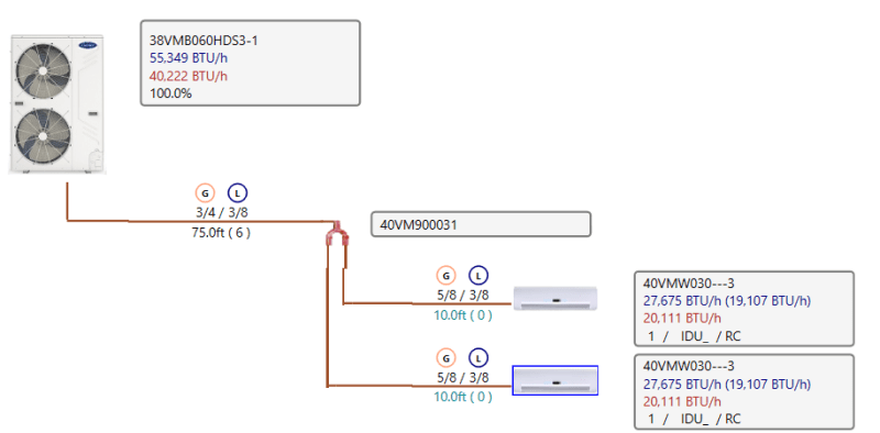

Staying with the minisplit idea for a moment I could do this. (2) 5-ton VRFs with alternating high wall air handlers.
If you are designing, you should determine the load. Their equipment likely has data on the design cooling load for each and they can tell you if they plan x% expansion.
I don't know those IT folks, but they likely aren't HVAC engineers qualified to do a load calc. But I could be wrong. If it is too warm, they will blame/sue you regardless of if they said 3 tons.
Whoever stamps and submits plans is the one responsible. So that person should size.
