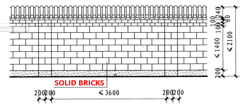

In which American code or standard is there requirement of minimum strength of outdoor wall bricks? International code is also OK.
In this country, the compressive strength of brick is 10MPa.But 13MPa is required in our project specification. Now I have to break this limit through calculation. But I don't know in which book and code are there design valves of compressive strength of wall, like Chinese code shown in the picture below?

Generally, the strength of the brick or conc. block will not be the limiting issue. But, its durability against environmental issues such as wind, rain, sun, general abuse, will/can be. Improperly made brick or block can just deteriorate due to the weather. For these kinds of walls, the bigger issue is total wall strength and stability against lateral loads, like wind, EQ, unbalanced soil or water pressure on one side, people or equipment lateral loads, etc.

The bricks themselves can be made from fired clay or from concrete. Both materials are masonry. Clay bricks are commonly called 'bricks' and concrete bricks are often known as 'blocks' or more correctly 'concrete masonry units'. When you asked about outdoor wall bricks, I automatically assumed clay bricks, perhaps incorrectly. Solid bricks suggests clay bricks with a frog, rather than perforated clay bricks. Are you actually referring to concrete blocks or clay bricks?
