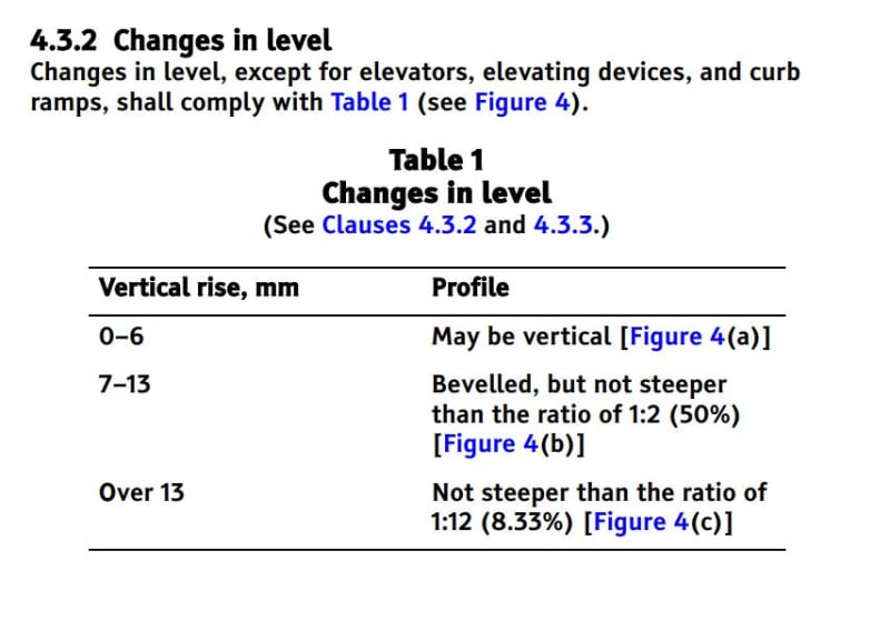

BTW for minimal deviations in pathway see CSA B651 or your local accessibility standard (I am mentioning this because you brought up 3/8" to 1/2" deviations as hazards). If something is a hazard depends on elevation difference as well as also the bevel/slope.

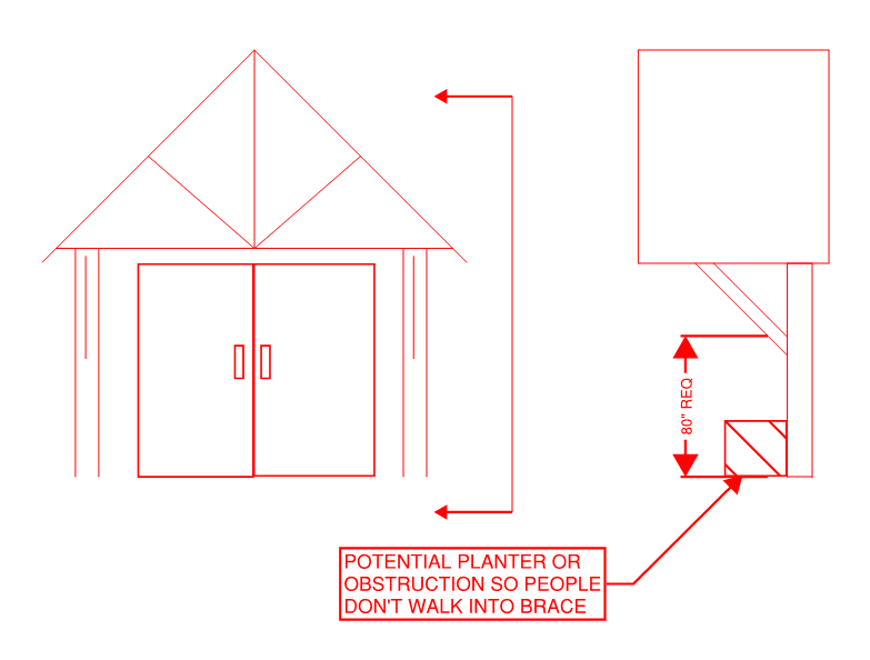

It would not block the entry way, but rather cause people to take a more direct route to access the entry way. See the screen shot below of a quick markup:
The concern is rather than approaching the door directly, people may come in from the side and potentially hit their head off the brace. We are looking for advice on substantial of an obstruction we need to ensure (1), it is clearly visible and people do not inadvertently trip over the obstruction (and then smack their head off the brace in comedic fashion!), and (2) an obstruction large enough to make it abundantly clear that there is no walkway passing under the canopy from the side, and that if you are to access the area, you must enter head on.
