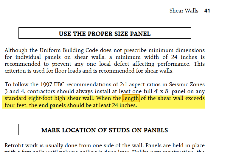

Also, I did come across this which may be cause for my previous thoughts, as I started under the 97 UBC. It wasn't a requirement, but recommendation:
An older AWC document about perforated shear walls says: "The minimum length is tied to the minimum aspect ratio, h/L, requirement in the governing building code. In most cases, this ratio is 3.5/1..."
The AWC SDPWS 2021 still requires that ratio is 3.5/1 for h/L.
Correct, but the document I referenced just highlights what I said above that the minimum length is dependent on the aspect ratio, not a set number.

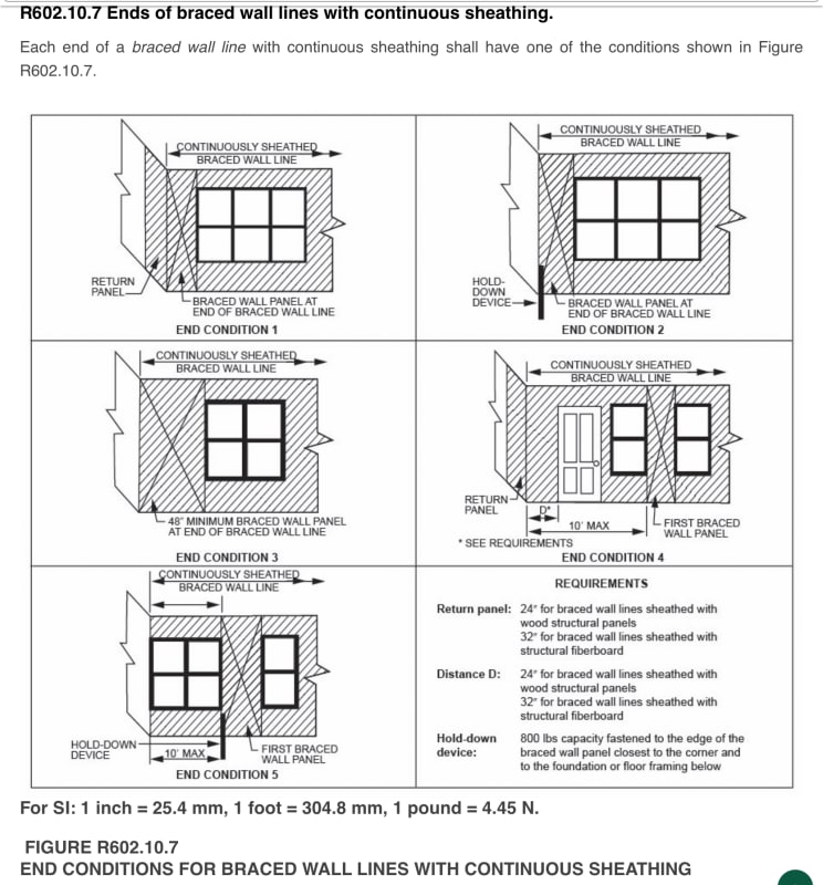

I think maybe you were referencing IRC R602.10.7
I defintiely wasn't thinking of IRC/CRC here in Kali...but that obvioiusly reveals a "best practice" not explicitely stated in the SDPWS.
