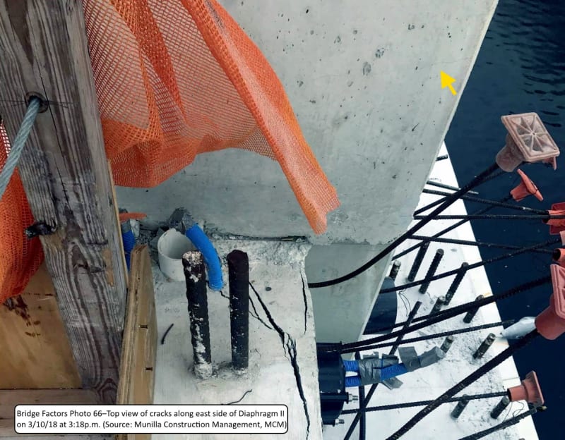

Like you, I have yet to identify where FIGG developed the lower design number for the connection of 11/12 members to the deck - the shear friction failure location. NTSB suggests they did not correctly interpret the results of the computer models.
There is a hand calculation in the FIGG design calcs that addresses node 1/2 using a "punch thru" set of shear planes thru the deck and out the end. I do not see a similar calc for node 11/12.
The slide presentation calc of the shear in node 11/12 was a similar calculation to that at node 1/2 in the design calc. That calc and a subsequent calc presented to NTSB included contributions from any reinforcing which could be identified in the region, not being limited to reinforcing intended to resist shear friction.
The FIGG calcs were made using a coeff of friction of 1.0, while the actual joints had received no roughening and a correct coeff of friction would be 0.6, reducing the contribution of all components by 40%. The NTSB concluded the joint prep was not a factor - it would have failed anyway.
As I recall now, that slide presentation did not address the presence of two 4" dia pvc sleeves vertical thru the deck and together at both sides of member 12. Nor did it consider the extensive cracking of diaphragm 2, which it assessed as having cracked from the vertical component of members 11 and 12. The horizontal thrust was greater than the vertical component and the joint had slipped maybe 1/2 inch when the slide presentation was made. Tests from WJE show that maximum resistance of a shear friction joint is developed at a slip of 0.020 to 0.025 inches - long before the EOR saw the actual conditions on the morning of March 15. It was downhill from there.
You may have answered your own question. It appears that almost no attention was given to tne need for node 11/12 and member 11 to "stand alone" during Stage 2 erection and until the entire double span structure was completed.
When complete, member 12 was to be "wrapped" and integrated into a concrete pylon 5 feet by 6 feet in dimension cast with the north span. And the north span was a shortened mirror image of the main span, so member 14 of the north span counters part of the horizontal force in member 11 in the final structure. The mental image of the huge pylon seems to have created a confidence in this area that overshadowed the importance of capacity at Stage 2.
And - can anyone confirm the actual reinforcing in member 11? The drawings leave some question of whether member 11 should have been considered a member "without PT rods" and therefore should have had 10 - #7 bars, or whether member 11 was a member with "with PT rods" and therefore was to have only 8 - #7 bars - in which case the amount of reinforcing does not meet the minimum requirement for a structural member. In either case, I see a visibly evident lack of appropriate reinforcing in the web members.

Member 11 was so badly damaged and under reinforced it could then have been the weak link.
Imagine this - the force in member 11 is 1.61 times the truss reaction at the pylon. For the reaction to equal the force value in member 11 would require a span length of about 240 feet (deducting any increase in the end span reactions of the canopy and deck ). This is where the imagination comes in -
Can you imagine an engineer supporting one end of a 240 foot long structure just like this on a 24 foot long column of the dimensions 21" X 24" and reinforced with 8 - #7 bars?
Can anyone?
Would cracking and splitting in that column like that seen in member 11 have caused any concern among the people at the meeting of March 15?

I also think the NTSB spared FIGG the coup de grâce. The NTSB puts little emphasis on the cracking that was photographed between 3:16pm & 3:18pm on March 10, 2018, 2-1/2 hrs after the transports were removed and 1 hour before the PT rods were detensioned. There was already a visible crack in member 12, longitudinal cracking in #11 and the spalling on the deck at the edge of the diaphragm was great enough to have been accompanied by cracking on the north face of the diaphragm. The bridge was most likely already damaged beyond repair. There was only one opportunity, to attempt to repair the concrete and that was while it was still on the SuperShores in the casting yard.
Emails between Figg & MCM regarding when the detensioning took place and if the photos taken between 3:16pm & 3:18pm, were before detensioning, establish that FIGG knew the new cracking had begun before detensioning.
I would disagree that there was ever any opportunity at all to "repair" the concrete. The design itself lacked any shear steel within the concrete for connecting strut #11 to the deck. The only "repair" that could have been done would have been to introduce a massive steel tie sufficient to "capture the node" at #11/#12 and tie it back to the previous node on the deck. There was not one possible modification to the concrete that could have had any preventive effect capable of avoiding collapse.
