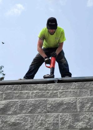

I have heard stories from field guys saying that PAF's do not work well on smaller bar joists as the flange deflects and they "bounce off". Not sure there is any truth to that but would be nice to hear other's experiences.

That happens but can be mitigated somewhat by A) using lesser charges and B) dialing back the setting on the applicator. The more annoying thing is that if you dial things down it will work well for some but not drive enough for others. The variability can be a real struggle; do expect some pins to completely blow through the flange on smaller sized members.
Overall though I'd still 100% recommend over welding. Here's me a couple years back looking like I'm about to miss a joist flange. They were very thin joists (20' span only moderate snow load) and the bounce was there but not enough to get in a fuss over. I'd wager the field guys you talked to are just used to finding a particular setting and not adjusting for the various material thicknesses.
