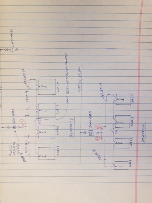

A one-line might help. I know exactly what GG's bifurcated feeder is, but that's not what I initially pictured. Two cables because the load is too much for one cable or two cables to two different loads? If two loads, are there two sets of CTs and two sets of relays or is there one set of CTs and one set of relays (I've seen both)? With out a good picture you could get a very good, but totally irrelevant, answer.
I've attached the single line.
I think scenario 2 provides better sensitivity to high impedance faults, although I'm not sure how the CTs would be physically supported, since the MV switchgear typically has a cable compartment separate from the bus compartment in the back of the lineup.
Thoughts?
Thanks,
EE
Scenario 1 probably allows for better CTs while scenario 2 makes it easier to figure out where the fault is. In scenario 1 the CTs are on the breaker bushing and the mounting is taken care of. In scenario 2 the CTs have to be in the cable compartment, can't be easily mounted, and probably have to be physically smaller. The "right" answer depends on lots of additional factors; available fault current being one of them as it affects CT performance.
