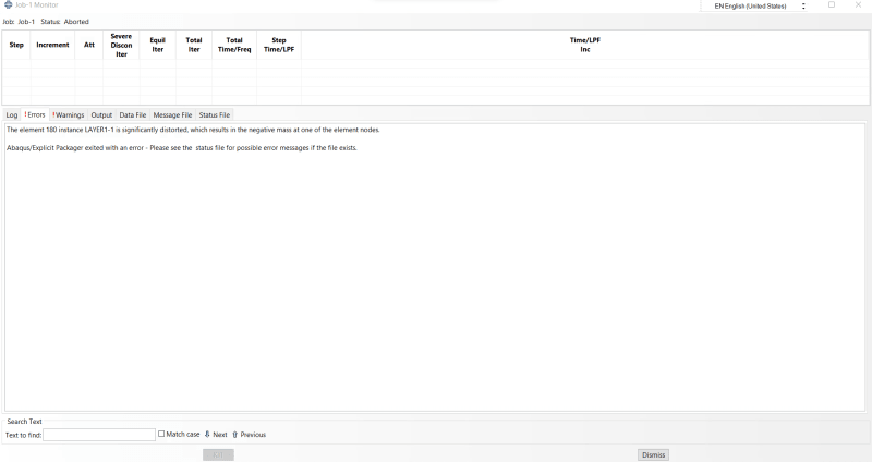

I was trying to test a hemisphere of 2 layer each of 50mm thickness made of different material for impact load and pressure. I received the above error after submitting the job. I modelled the shell(hemisphere) as solid 3d deformable. I think the error is due to meshing, can anybody help me with it ?
Those are just warnings. What are the error messages ?
The mesh is way too coarse (especially in the thickness direction) and parts are thin-walled so you should also consider using a different type of elements (e.g. continuum shell).

This new shell mesh should also be refined, the elements on both surfaces are too large.
I am new to abaqus so I am having a lot of difficulties. It shows element distortion error when i try to make the mesh size small at impact location. I did managed to make my mesh size resonably small for the solution. But, there is variation in my result if i change my time duration why does it affect my result so much. And, what should the distance between the surface of impact and impact object ?
The time period in dynamic analyses corresponds to physical time so it's very important. For example, your projectile will travel a different distance depending on the time period of the step.
The standard approach is to place the impactor right next to the target since there's no need to simulate its whole travel to the target - there's no air resistance anyway.
