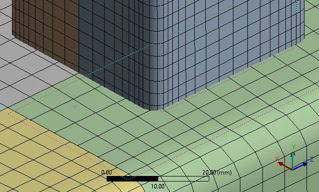

Please, I try to fix this mesh in my model, Can you help me please?
Both are surfaces created in DesingModeler (two hollow square section hss)
I assume you mean that the two sections are not connected at their common interface/ meeting point?
If that is the case, just make these bodies multi-body parts, and the mesh will then be connected/compatible.
This can be done by selecting them in the body tree, right click and choose form new part.

The two bodies should probably just touch, that is the vertcical RHS (with finer mesh), should have its bottom edge on the same level as the horizontal upper face of the RHS at the bottom of your picture (with coarser mesher).
Like in the example below the circular pipe left edge is on the same plane as the right surface of the RHS.
Then to generate a common connection between them (thus a compatible mesh) do as shown below (in DesignModeler):
