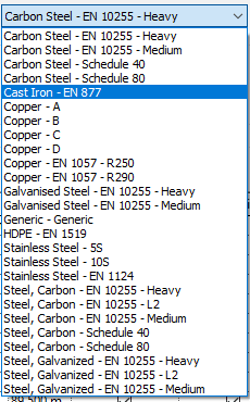

Hi Dears ,
recently i got a Project for Stress analysis in Australia but i have a problem , Most of pipe in that project selected according to AS/NZS Standards , which pipe classified by Light /Medium/Heavy / ...ETC Terms and i am not familiar to these, on the other hand
i need to have access to some Properties such allowable Stress and ... of Relevant Pipes for Progressing in my project ,
Could You please Guide me about relevant Codes and Standards in AS/NZS till i could get info about Pipe .
USED PIPE :
MEDIUM RATE CS
HEAVY RATE CS
Thank you

Dear LittleInch , Please check this
EN 10255 - BLACK AND HDG STEEL PIPE
i could not Find how upload mentioned Standard PDF , If you need PDF Please just Send Email to
MohammadjamaliBh@Gmail.com[highlight #CC0000][/highlight]
As i suspected I think this is pipe used by the building industry for water pipes, chilled / hot water or similar.
however I would use those stress values and wall thicknesses if you can find them in that spec (EN 10255). I can't believe they will be any different.
