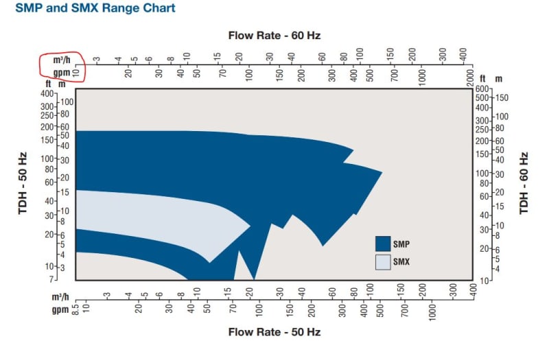

Looks like the pump application/selection is wrong. PD pump would be a better pump selection.
Mobil DTE-25 has kinematic viscosity of 44.2 mm^2/s at 40C, which you have a max of 35C so it will be thicker.
This SMP pump is for water and the flow rate range on the curve only goes down to 10 GPM as a minimum.
Hi Shaggy,
A positive displacement gear pump is what came out. Those had their own issues. With the trimmed impeller the flow rate can be lowered. The stock charts are for the 4 inch impeller.
You are correct that this pump is listed for water service only.
