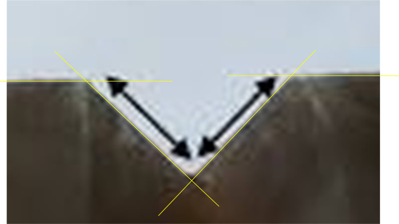

Below is the image of a hot steel rolling mill roll having V Groves.
I am trying to measure the length of each side of the grove as shown in the figure accurately.
Currently I am using a normal ruler but as you can see it not accurate.
Any other proper way of measure the grove length accurately, hence checking the symmetry of the groves????
(Any different tool or caliper? ?)

Take a sharp pointed dividers from your drafting tools kit, and put one tip in the bot. of the groove. Open the dividers to match one of the slope lengths, swing the dividers to check the other slope at that point. Measure the dividers tips with your ruler or a caliper, or some such, and average the two readings at that point. Do this at a number of different points on the roller and average those. You should be able to get a pretty good measurement reading on a ruler to +/-.01” or .02” by eye. The measurement on the two mating rollers won’t be the same, as a function of the material thickness you are rolling and the wear on the two rollers. Have a good friendly, local, machinist do it. They’ll know how.

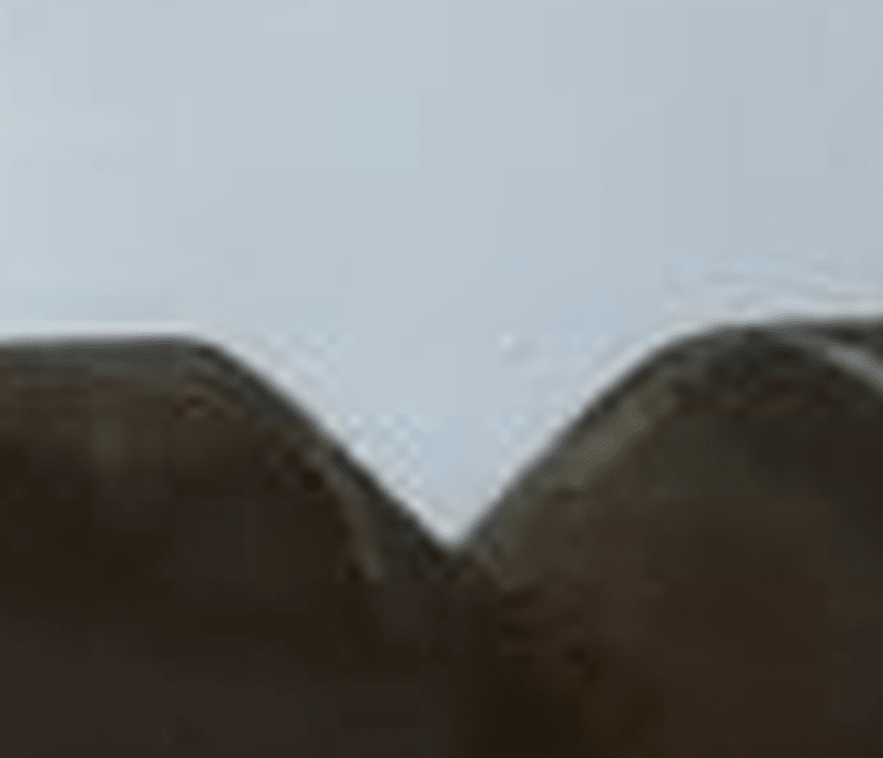

It seems to me that your primary issue is not the measurement, per se, it's the measurand, i.e., the reason you are having measure the groove dimensions is because the grooves you took a picture of are horribly machined. By any measure, the groove on the right in the first image is very ill-formed

You will also be able to see the defects- as your second groove in that picture is not conforming.
@IRStuff, the part seems to be cylindrical. The "ill-formed" edge of the groove is actually of a circle curving away from you as far as I can tell.

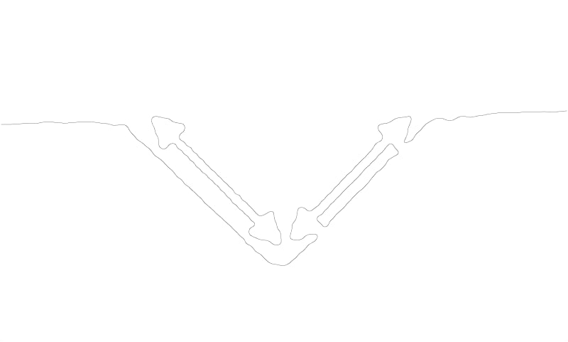

Yes, pretty obvious, now that you point that out. So, imaging would still be the most accurate, although getting the angle and orientation correct would be the biggest challenge. The other groove in the same image is almost straight-on. There are dimensional measurement imaging systems that have software to do the calculations for finding edges, etc. I used ImageJ's Canny edge detector on a zoomed in version of the OP image for the second image below.
Thanks IRstuff for the method and I tried it. Clicked some pictures and yes, angle and orientation problem is there. It take some amount of time to align the camera. But this method is pretty accurate​
