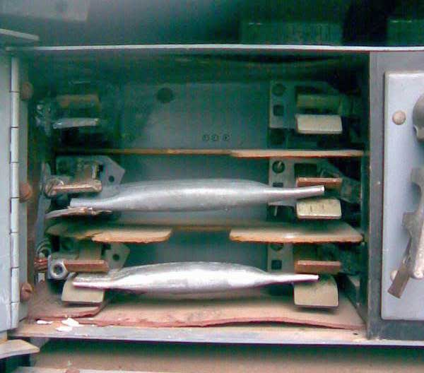

When all you have is a fused disconnect, and all you needed was a switch
This is a real part.
