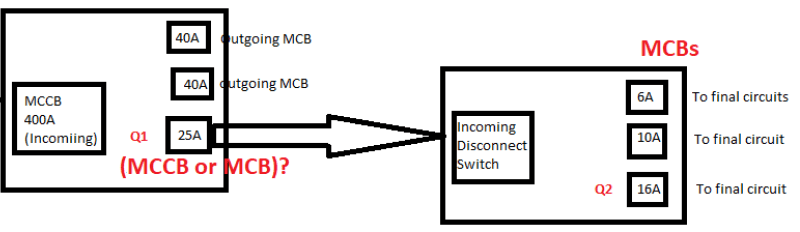

Now I have a question of whether to use MCCB or MCB for the breaker Q1 in the below picture. I prefer to use MCB because of the cost over MCCB. Does using MCB has any disadvantage/ code violation?

"... Now I have a question of whether to use MCCB or MCB for the breaker Q1 in the below picture. I prefer to use MCB because of the cost over MCCB. Does using MCB has any disadvantage/ code violation? "
1. I take it that the Q1 (25A) is sufficiently [short-circuit kA rated] at the 400A board. Then, it does NOT matter whether it is a MCCB or a MCB. The important criterial is that Q1 shall be sufficiently kA rated. MCB is usually lower in cost and smaller in physical size. Attention: usually the (400A board) would be of higher kA than that of the downstream (incoming disconnect switch) board.
2. Whether MCCB or MCB; they do not offer selectivity at high short-circuit current, as we had looked into it earlier.
3. BTW: The (conductor) shall be sized that is [protected by the 25A breaker]. Therefore, the (final board incoming) may be an [disconnect isolating switch].
Che Kuan Yau (Singapore)
