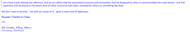

Na... I don't run usually... just solve problems... doin' that for over 50 years. Owner has been informed and we are awaiting new information... suggested owner hire a student to prepare an 'existing' roof plan cad file with all the info on it. Another new one... I'd posted a query of concrete thickness for steel stairs. for a 4' span, I've indicated the tread should be 2-1/2" of concrete and the owner wants to use 2"... he originally wanted 1-1/2"... just cannot get away from it these days... my only reasoning being that is the thickness, I'm comfortable with.

If I may, I want to use dik's query to talk about a broader topic. There are always components of any job, regardless of whether it is delegated or not, that we as designers cannot verify the adequacy of. Naturally, if we deem it to be an important system we must indicate that even if it is not us, some professional must take a look at it. This typically pops up on most of our DWGs as "designed by Others".
Now, I don't think the above is in controversy. We don't look at every subsystem all the time on every project. Nor should we be expected to.
On the other hand, at what point does it become ethically questionable to stop at saying someone else needs to look rather than requiring you be given the mandate to be that person (or else walking from the job)? At what point is a system or subsystem so important to the project that even if not given the mandate to do the design for it, we must put our foot down and say we need to be party to the design or else we cannot be involved?
I'm honestly not clear on where that line is to be drawn.
Enable, I think you raise a good point. I don't think there always is a clear line. A general guideline that I would start with is requiring our involvement if our lack of involvement is likely to result in an unsafe situation.
For example, it may be ethical to certify a load rating for a beam conditional on specific connections and supporting structure if we know that other competent engineers will verify that the connections and supporting structure are suitable. If we think it likely that no engineer will verify the suitability of the connections or supporting structure and the beam is likely to create an unsafe situation (justified by our load rating), then it may be unethical to certify a load rating for the beam (even with disclaimers that we know are likely to be disregarded) because of the safety risk it is likely to create.

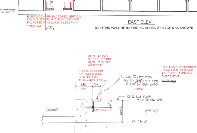

A recent example on one of my projects to design some angle supports for curtain wall... this was the load information I was given.
and this is the manner I handled it...
I've not encountered this type of problem before. Connection geometry is bad and I don't know what of the load is supported by the curb and what by the angle. Minimal clear edge distance for the fasteners and fastener too low on the angle. Missing from the snapshots is that the loads are supported by two fasteners plus a bunch of added printed material not shown. Vertical load eccentricity shows up on another sketch.
