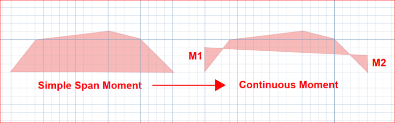

If given the following known variables, M1, M2, V1, V2, anyone know an equation for finding maximum positive moment in a continuous beam model? See image for details.

Sorry for the confusion rb1957. Should have specified how I got to this point. Modeled it as a fixed end model. Then used the FEM's using the theorem of three moments to get the negative moments. Now I can't figure out how to get the maximum positive moment.
Something like ql^2/8 -(M1+M2)/2 for a uniform load?
To do what you're proposing, it seems that you would need to somehow work backwards from the FEM's to get the disposition of the actual applied loads. I don't know that's possible without making some assumptions. For example, the same FEM's might be produced by either a uniform or a concentrated load.
Like KootK mentioned, you're going to have to tell us what the member load is. Uniform, point load, series of point loads, some combination?
I don't think I understand where you're coming from. You've already done the hard part. With the end moments and member loads, this is a basic Statics shear and bending moment diagram problem.

If there is actually no load on the span being considered, the end moments should be the peak moments, both positive and negative as applicable. Your moment diagram would be a straight line, right?

If the span is unloaded then peak moments are at the ends. If the span is loaded then you can either do a numerical root finding algorithm on the shear or determine the actual shear formulas and solve for the roots exactly. My own thread on a similar topic: Link
We would need to know the loading to get the max moments.
For example we know the difference in shear between point 1 and point 2, which tells us the total load difference. But, that could be a point load applied near 1, at mid-span, near 2. It could be a distributed load, or a combination.
If I remember correctly, for a simply supported beam, the maximum span moment is the sum of the shear areas from the support to where the shear change signs (where V = 0). For a continuous beam, it is the above less the area under the negative moment.

See below:

Pattern loading sometimes controls for continuous beams. IIRC, it can wind up being (the equivalent of) a simple span moment if the pattern is right. (I.e. M=wl2/8)
