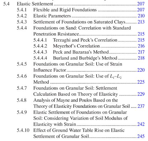

For shallow foundations the local geotechnical engineers have more knowledge of past performance in the area, but for reference on theories I would recommend DAS's book on shallow foundations. Specifically for sand your dealing with elastic settlement, table of contents below.

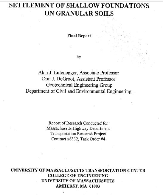

Take a look here. I have found Hough's charts fine an 1" settlement criteria. I found it on he Internet. Many pages.
