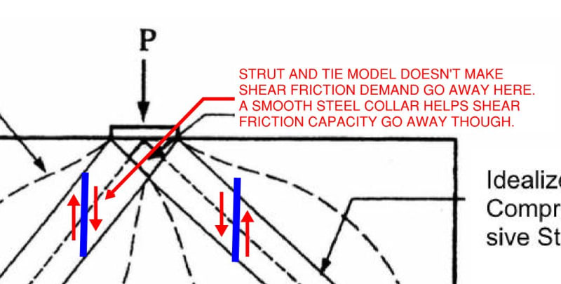

Why not?? Because the concept is deeply flawed, that's why. At the least, that's how it has appeared to me over the last 2+ years that I've been contemplating this.
Please refer to the attached article and the sketches shown below. This is an innovation in foundation punching shear design that's been put into practice on some significant buildings.
What am I missing here?
If it doesn't work as intended, it would be a helluva thing to repair...
Right? The paper that I attached describes some validation testing. However, I worry that validation testing setup directed the vertical load straight into the steel ring in a way not reflective of how a full scale column joint would be expected to behave.
They took all that time to weld 200 shear studs to the sides of it...why not add a bunch more to the inside of the collar thingy?
I don't know that it would actually solve the problem, but at least there would be something to point to and say 'theres the load path!' Right now there isn't much...
I don't get why someone would do that rather than a (traditional) bent bar arrangement. If you are having to put in a monster like that......most likely you are going to have shear problems beyond it's influence.

Yeah, internal studs or friction was the best that I could come up with and I don't see the studs. And, even then:
1) I imagine you'd be looking at a few studs for an 80 story building column and;
2) One would need much larger reproductive organs than I have to rely on bare surface friction.

Exactly. I drew what I thought the governing mode would be but, you're right, one would seem to have another failure surface to deal with not so far from the original. I'm not sure how much to read into their STM model but the location of the ground reaction arrows sort of implies that spread isn't actually required beyond? My understanding is that this originated in the NY highrise market. In NY everything's on bedrock so maybe that's legit. At the least, it might explain why these things aren't collapsing.

Part of my interest in this is that it dovetails into my thoughts on shear friction: Shear Friction: Where and When?. In the linked thread, and many others, I developed my theory that shear friction is alive and well as a necessary mechanism anywhere that concrete is exposed to a transverse shearing force component. When I look at the strut and tie models in the linked paper on this, what I see is a failure to appreciate this.
Think strain compatibility...not just with regard to rebar and concrete, but with all components...particularly the steel monstrosity.
Kootk....agree with your sketch...the steel frame is useless.

Human, while i could potentially agree with that (that the studded fins are just an alternative to punching shear reinforcement Links), I think the collar lets the whole system down by creating a slip plane between column and the very foundation it wants to punch through.
This would have some chance if it didn’t have the collar.
That node in the left side of figure 4 has a plate to carry the weight - this has an open hole.
The model in fig. 13 shows load applied directly to the steel; again, the actual use has a big hole for the load to pass through. The test diagrams appear to show a substantial steel bridge across the test item, plugging that hole.
The one-way modules look more realistic a load spreaders; the two-way evaluations look overconfident.
Why would the test article not include a section of column as that is the way loads are introduced?
