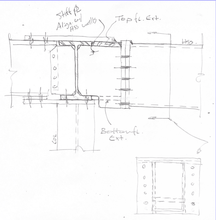

In these situations you can clean up some of the congestion by using shop-welded extensions of the members. This provides some separation between your field-connected elements. But use the shop-welded extensions sparingly; you're essentially doubling your connection costs for the extended member when you do this.
See below for a rough sketch on how I'd try to approach this. Shop weld a built-up HSS section to your continuous beam and connect the HSS with a bolted end plate.

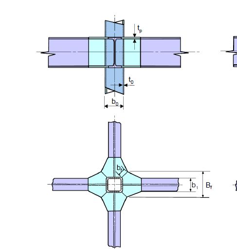

I would consider , extending the W200x36 Column to the top and provide through plates (Flange diaphragms ) at the top and bottom level of HSS356 and make the connection apart..
I would provide a sketch but preferred to post the following excerpt ( from HOLLOW SECTIONS IN
STRUCTURAL APPLICATIONS by WARDENIER )
..My opinion ..
P.S You may delegate the connection design as long as if you can make sure the connection designer get the full concept of the structure .

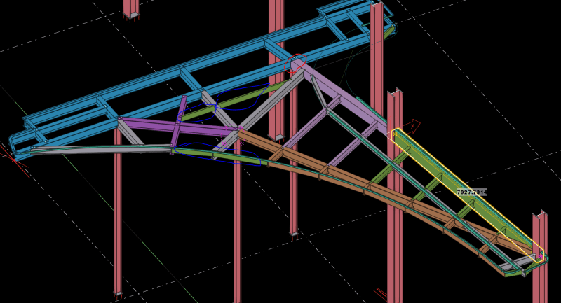

I have also attached a little model of my canopy roof (building not shown) so you can see the joint that is in consideration (circled in red) along with what this canopy looks like. I Have color coated the members into one matching color for the ones that I will send as one frame in the shop. The four green channels highlighted in blue along with the grey members are stick members.

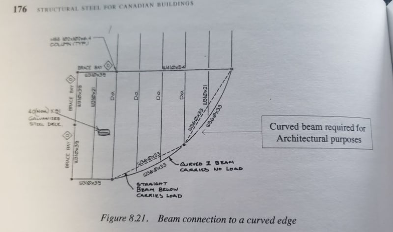

onlym112 what they're saying is you should politely suggest to the EOR other framing arrangements might be better (but dont say better...say safer, greater factor of safety, yadda yadda - politics and all). Sometimes the primary members should be dropped and concealed in a curved façade to satisfy architectural. Here's a similar example from Structural Steel for Canadian Buildings that does that quite nicely. Throw something like this at them and see what they say. Sometimes we get lucky and it's like the movie inception (...it was the EOR's idea all along).

The general concept of the framing is similar to the snapshot provided by Enable; the orange and purple members provide the support around the perimeter, curved portion cantilevered from the straight perimeter beams, and the main roof infilled. I can only assume the purple beams have been positioned to support something not shown and it looks like there is a bunch of secondary steel that makes the framing look worse than it is. Regarding the torsion in the HSS - this is just a snapshot of a partially complete model...there could be a 50ft tall sign cantilevering up from this thing for all we know.

It feels like that long, brown girder should be pulling in a lot of the canopy load and leaving those HSS box girders alone in regards to torsion. UNLESS the system is over restrained and the model is revealing that the torsional stiffness of the HSS is greater than the flexural stiffness of the brown girder. Then the HSS may be reaching out and picking up the girder (which wouldn't be wonderful) and resulting in alot of torsion. Am I seeing that right?
Also, what is going on between the cyan girder you're attaching to and the column to the "north east" of it in your figure? Is that cyan girder cantilevering out and just scabbing onto that large column beyond or are they independent of one another? If it's a large cantilever, I feel like it'll be loosey-goosey - especially if you're dumping in torsion. If it's attached to the "north east" column eccentrically and flimsily - I'm not sure what that looks like or how it'll perform.
