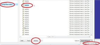

save as config.pro then set working directory (on new config.pro file)
