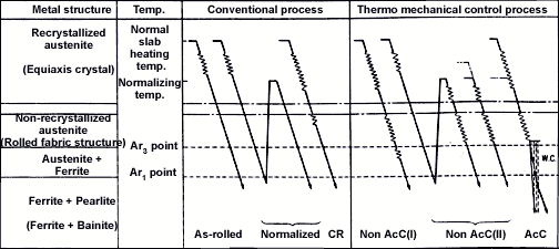

We have ordered a BW A860 X65 package ,and asked to factory about starting plate .

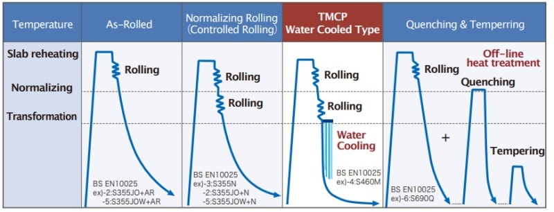

They confirmed that ,using TMCP as Starting plate with additional Q&T or Normalized heat treatment for reaching A860 toughness @ -46.
It is generally accepted that these steels are not designed for subsequent PWHT and may suffer some degradation in their mechanical properties when re-heated above critical temperatures.
A number of standards, specifications and technical publications acknowledge the influence of PWHT on mechanical properties of the TMCP plate, but provide limited guidance (depend on supplier quality) on how it will affect the properties.
Would you Please help me about such a Manufacturing process Issues and possibility .
But you will not be doing PWHT on the TMCP material, you will be doing it on Q&T material.
A Q&T or normalize will effectively erase the TMCP thermomechanical history.
So now you are left with chemistry questions.
A different animal.
It may still present issues
The same microalloy elements that help HSLA steels achieve their phenomenal properties are bad actors in the HAZ during PWHT.
Google 'stress relief cracking'.

So what if they start with TMCP if they then run it up to 900 deg C and quench it? Good luck to them as TMCP is pretty lean for responding to a quench. If they are successful, as demonstrated by a manufacturing procedure qualification (you did specify one didn't you), then all you have to worry about is keeping your PWHT temperature at a suitable temperature margin below the tempering temperature.

@peter vaf - given your stated text, you appear to be totally missing the point. The starting plate will be TMCP. The fitting manufacturer will then process the plate into a fitting. In so doing, they will RE HEAT TREAT the material under a quench and temper cycle. The TMCP microstructure will be totally changed, and the material will now be quenched and tempered, and no longer TMCP. Get TMCP out of your head.

The fitting manufacturer will still have to mechanically test the Q&T plates to verify minimum tensile and impact properties. One would assume that the fitting manufacturer would purchase Q&T plates if they could find them in the required time frame.
@peter vaf. It's down to the fitting manufacturer to work with what they can get so long as the end product meets the technical requirements. Take a look at A860 and read the heat treatment section. You will note that it doesn't matter what the starting material condition is. Just go with it and stop panicking.
