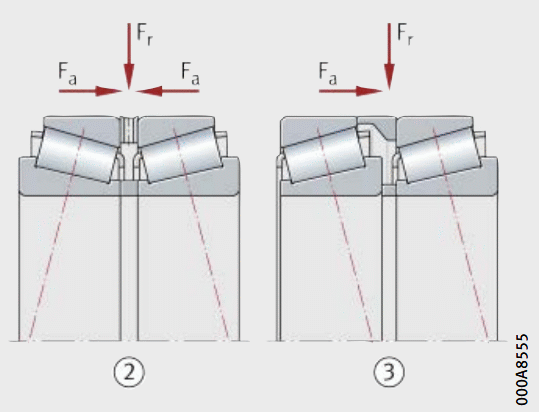

Hi everyone.
I am designing a manipulator to hold the dashboard in an automotive company, the manipulator is supposed to carry a load of about 120 Kg at a maximum distance of 5 meters and it is used to transport that payload inside the car.
So I designed a system to have several rotational links and one linear motion at the end of the manipulator. As you imagine there is alot of axial load and moment, so I designed the bearing blocks for the rotational links as two taber bearing in an X configurations as seen in this image.
my current problem is that when I add the final link of the system, the manipulator deflects greatly at the bearing blocks as seen in the image.
Deflection at the bearing block
I have tried changing the bearings to larger sizes but its the same problem, I think its a problem of selection of taber bearing. is there any other bearing selection(I have thought about using a combination of thrust bearing and roller bearing) that would solve this problem or is it a problem of needing to use counterweight or wires to support the system while rotating holding the links in place using some pulleys system?
I really need your support in this, appreciate any responses, thanks

Why not a rigid stub shaft bolted or welded to horizontal member with two ball bearings that can take both radial and thrust load?
Walt
You need more distance between the bearings
120 kg @ 5 m = a lot of torque.
As I put in my other response, the single bolt to hold the separate pivot seems like a bad idea.
Your device will never work acceptably, and I do not see any way to fix what you have. You are trying to reach far beyond what your size of structure can support. It is not even capable of supporting its own weight, let alone a load. Remember that strength and stiffness are two different things. When structural engineers design structures they have to allow for deflection. Floors may be designed to deflect less than 1:180 of the beam length at worst, which would be horrible for your application. You have to get your load to the floor in a much shorter distance, or build a much stouter structure. You can do this by moving your device on floor rails or overhead beams to cover most of the distance you have to cover. Cantilevers are the least stiff design you can use.

At first glance your problem is the prising moment on bolt 1. Work out what angular deflection you'd expect there. The solution is to use a flanged shaft, like the half shaft on a live rear axle.

On the other hand, if you absolutely must use your current setup, use deeper sections on the various links and make them from aluminum and make sure that they are hollow and closed sections to reduce torsional deflection. As for the bearing carrier, you need to spread them out significantly, as some of the other posters have mentioned.
Engineering is not the science behind building. It is the science behind not building.
That's an unusual amount of deflection. Is there enough preload on the bearings? Tapered bearings can be installed in two different ways - one maximizes stiffness. I don't recall which way that is.
The shaft and housing are steel, right?
The deflection is insane. What angle are the tapered bearings? What tolerances are you using? Do you have the bearings oriented correctly; I think you want either the so-called "O" or tandem arrangement:

That is alot of torque for bearings that are only spaced at about 40mm????. As already mentioned.
125KG x 5000mm))/40=15,625 KG radial load. ?? plus the axial and dead wieght which is not trivial. What are the specs on that bearing that busted?
We use self aligning tapered roller bearings to handle a moment of 681KG at 3M. But they are spaced at 355mm.
