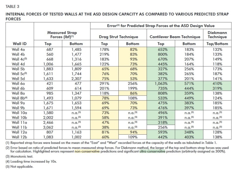

It's like FTAO, folks, the analysis produces safe design but isn't all that literal versus say testing or FEA. Look at some of those papers, you're satisfying statics here.
Evaluation of Force Transfer Around Openings – Experimental and Analytical Studies, APA M410, 2011.

I don't think a blanket statement can be made like that. These aren't exactly energy methods, but I'm not aware of any attempts to compare FEA to testing, there's been attempts to compare the mechanics-based approaches on FTAO (Diekmann, etc.), but there's spread in those results where they are sometimes conservative, sometimes not, which would put them in the category of energy methods because they don't follow the lower bound theorem.
I've made some attempts to compare the Mechanics-based FTAO hand calcs to an FEM based approach back when I worked with RISA. I think it worked pretty well. It felt a good bit more rational and reliable than the hand calc methods.
One of these days, I really need to do a proper write up of the procedures I came up with (that the current RISA method is based on).
