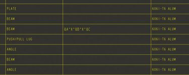

Ok here goes. I have a parameter in all my parts "SIZE" for the BOM. It should show the height width & length of the part.
Can I write a relation to have creo do this automatically and also have the format look like this:
"123.00 X 456.00 X 789.00" I want the x's in between.
Possible? If so how?
Thanks in advance.

Thanks Mike,
Sounds like what I want.
I will find an example file tomorrow at work for you.
I like your signature----- "Git er done"
Thanks Canoe,
But I get the note in the bom it doesn't pickup the dimension number. See pic.

Wait a minute! Success!! Had to update the BOM.
Thanks Canoe I owe ya!
