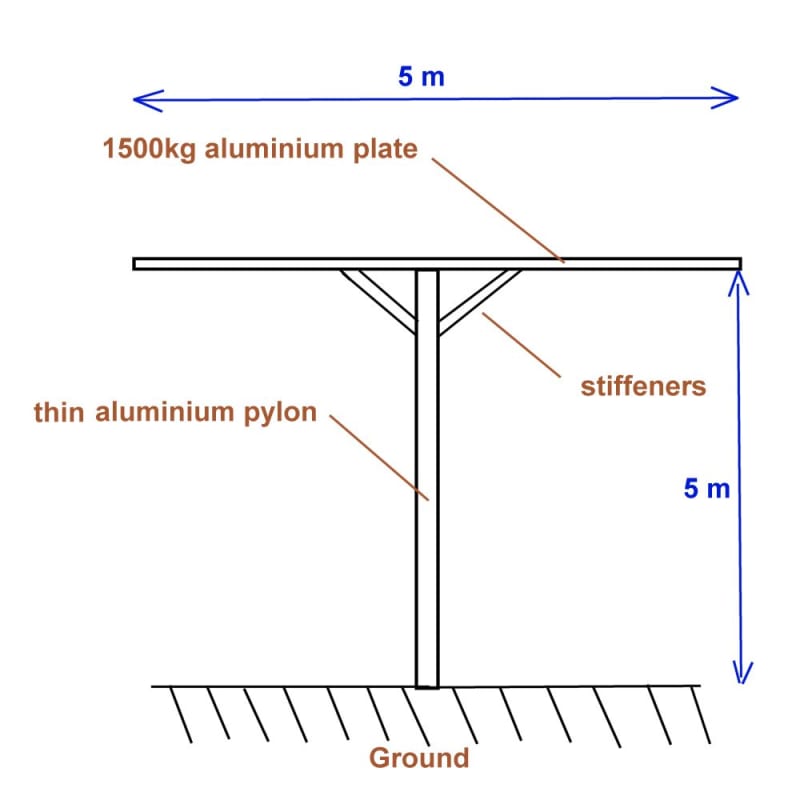

here a little sketch to better understand my concerns
the weight of the pylon would probably be around 500 kg
so i have a heavy load on top of the pylon and with a simple modal analysis, i found some vibrating frequencies at 1.3 hz in torsion and 1.6hz and 1.8 hz in bending
that why i would like to investigate a little bit more in that direction
with fea Catia module "elfini" software, i could probably do all necessary computations, but i don t know how.
i wish that my sketch will help understanding.
Thanks a lot and have a nice day
Sébastien
I'm sure this is explained in detail in any dynamics textbook and I'm sure there are more guys here who know how to do it by hand better than I can, but I'm the only one here so I'll try to give you my view on it.
I did a quick model of something similar to what i believe you have (I added more weight on there to get relatively similar frequencies.
First, I'd suggest making your column a bit softer for bending to get the first two modes in translation (I varied the stiffness of the pylon to get the first mode as translation). You could also change the plate or maybe even the stiffeners, play with it.
I'm not entirely sure if it matters for simple structures like this one, so my instinct is to try to avoid it.
When you have the first mode as translation in x, and second in y you can do the following since it's simple SDOF system:
Go to the code and make a spectrum (figure 3.1). It'll look something like the thing on the bottom of my drawing.
Take the first frequency (or equivalent period) and find the value in the spectrum that correlates to that value of period (you can see in my drawing that the first period is 0,7 s and i got Se = 0,066 m/s2 for that period.
From there you multiply this acceleration with your mass to get the equivalent lateral force. This force is applied at the level of the mass (in your case at the top of the pylon). The rest is exactly like any other force.
You do the separate analysis for the other direction. You don't really need to do any complex combining of two directions because the forces will be small.
Now again, this is simple like this because it's SDOF and because torsional mode is pushed back (it's the third mode).
Another thing, note the exclamation points ! in my drawing. This last row shows me how much of the mass is activated in these first three modes. You can increase the lateral force by dividing the 1 with that number (if your software provides the mass) so in my case, I could multiply the end force with 1/0,75 = 1,333.
A good control of the fundamental period would in this case be (in my opinion) K = 3*EI/h^3 and T = 2pi*sqrt(m/k).
I hope this helped at least a bit and that I didn't misguide you in some way. For any more complex analysis I'd suggest that you invest in a dynamics textbook and read it. That's the best way to understand it.
 https://files.engineering.com/getfile.aspx?folder=aaac695d-4858-47ff-8439-07300bc5f5e6&file=drawing.png
