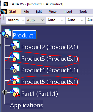

Hello. How to refer to an element of not all open documents of the catalog, but only the active document?
without using selection.
For example, I want to refer to the elements shown in the picture:
CATIA.ActiveDocument.Product.Products.Item(2) or CATIA.ActiveDocument.Product.Products.Item("Product3.1")
And what if I need to refer to the root product?
If that's not obvious to you I strongly recommend studying Automation documentation.
