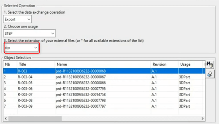

Does anyone know is there option to export drawing to pdf file in 3Dx? I saw in API reference that there is no anymore method ExportData as was the case in CATIA V5, is this method replaced by some other or it is completely removed from API in 3Dx? Issue for me pop out when I got task to go through tree with 100 parts and to export drawing for every part in pdf format, which can be quite fatigue if you need manually loop through tree and export drawings.
Hello @ferdo here I only can see offered STEP and IGES formats not pdf.
Do you mean in your 3DX installation or in the clip? If you don't have it in your installation, ask your VAR why is not exist, maybe you need something in addition... another method is to check if you have derived formats and maybe you can export from there (also from ENOVIA)
Regards
Fernando
I was thinking on this from your clip
And there I didn't find offered extension *.pdf. How can you do it through ENOVIA?

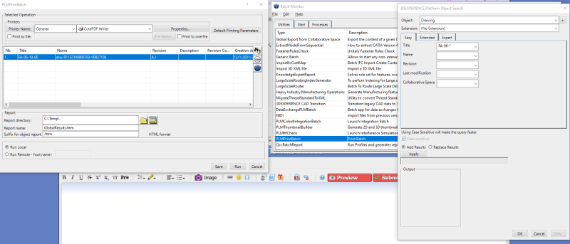

I found this PLMPPrintBatch, but it just put similar manual work of exporting drawings in pdf file :/, anyway thanks for first link it is interesting but I doubt that I have licence to work in that workbench mentioned in 3ds forum.
I agree will give a shot and see how it will go.
Anyway what came to my mind is that PrintToFile method could work, but one downfall is that it creates file with prn extension so I need to find prn to pdf converter.
