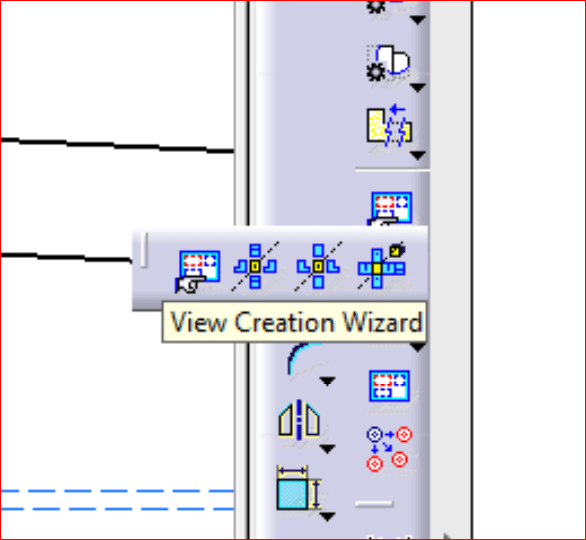

Why don't you use Catia's "View Creation Wizard"?...….
It is very simple!
CAD 2015

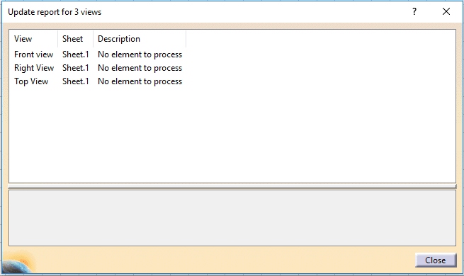

i have an update
i do a macro who creat front and right view of a catpart, know i wanna do the samething for a catproduct

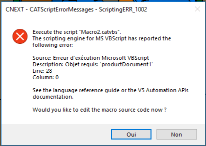

so i change the red statement by that but it doesn't work
Set product1 = productDocument1.GetItem("Product1")
also i wanna do a cut of front view i need help to do that

Yes exactly i get a message error
Your productDocument1 variable is empty, which means that it was not assigned properly. I do not see any line in your code where you assign ProductDocument into productDocument1 variable. Something like:
Code:
Set productDocument1 = CATIA.ActiveDocument

it's really strange, i do my assembly in DMU navigator so my code work but i had this message
