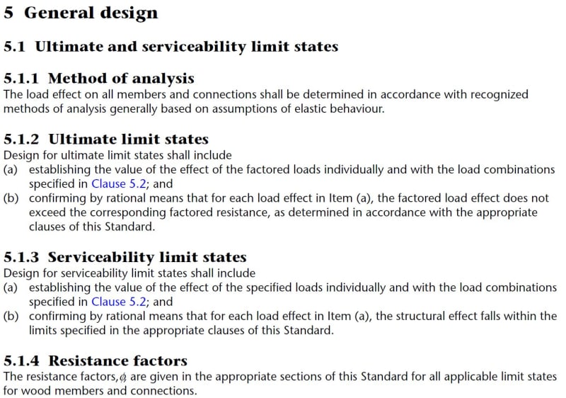

I'm not big on wood, but usually the Standards, in transition, recognise WSD and USD. Looking at my latest wood code (CSA O86-14, there are newer editions, there doesn't seem to be a WSD approach). I'll check with my wood guy to see what's up...

Just heard from my wood guy... ASD hasn't been in Canadian Codes for years.
