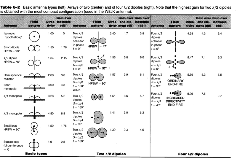

Now this is starting to sound like fun. Do you know of any web resources that show antenna styles and roughly what kind of patterns they project?

This might help, Keith:
Near the right-hand side you can see how multi-element antennas affect the pattern... pretty much everything out there is some form/combination of what's shown above.

Thanks Dan! Just what I was looking for.

I mentioned the Quadrifilar Helix as just an example that is arguably outside the posted 'Table 6-2' menu. It wasn't intended to be necessarily applicable to this application. The intended point is that the total range of antenna concepts and designs is vast, beyond the array of options presented in Table 6-2.
