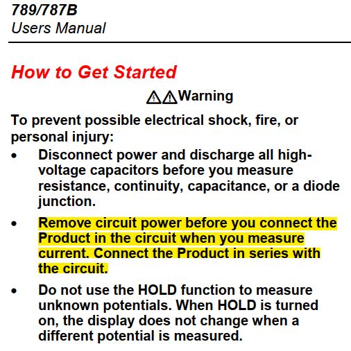

You're better than me if you "can read Ma (sic) without breaking the loop" when the photo on your linked site shows conventional meter probes (not a clamp-on pickup) and the 789 manual on the Fluke site says that current measurements are made in series, in the conventional method:
There are Fluke products that do allow for loop measurement without breaking the loop, as far as I'm aware the 787/789 are not.
Those products are generally pretty solid, I don't know that they're immune to wrong probe input issues though.
