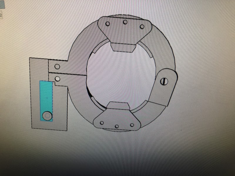

I have a problem I'm struggling to solve.
Think of hand-dropping a mortar round down a tube then moving away. I want to be able to do that, but remotely and without electronics/solenoids etc. An video example of what I'm trying to achieve is here:
I've got a potential solution, but I'm stuck on how to 'release' the mechanism (ie, let go of the round and move away from the tube).
So, I've got a way to hold the 'round' in place, but unsure how to release and get it out of the way.
The current solution is below (from above vantage):
Here, in Position A, it is holding the object. Once released and it changes to Position B, the mechanism springs apart and falls to the ground. What I haven't yet solved is how to release/hold the mechanism together. We've toyed with the idea of a cable to remove whatever captures the two square ends, but I keep running into challenges.
Without going too far in a certain direction, I'm thinking of a cable pulling on a ball-pin which is holding the two parts together, as per below image.
Can you poke holes in current idea, and suggest improvements/better ideas? Thanks.
PS, apologies for shoddy drawings, just playing with designs at this stage.
I don't think it is any better but maybe try an extension spring instead of a compression spring - so spring tends to open the hinge. Use a clip to hold it closed then pull the clip off.

hi Mechbob1
How does the ball pin re-engage with the holes after realease?
Good idea, Brian. That would simplify the release. I presume you mean to use the extension spring at the bottom of the picture with a release pin through one end?

Desertfox, after release it’s manually reinserted. There’s a fair time gap between iterations
Hope this helps.
When you place the device over the tube with the round in position, what keeps the device in position over the tube while the pin is pulled out remotely? It appears to me that the device will fall off the top of the tube when you try to remove the pin.

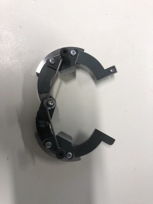

FWIW, the design has had a few changes but several initial tests were successful. It released as planned. Not at finished stage yet, but here's where it's at:

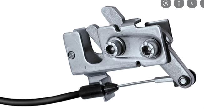

I see your mechanism is spring loaded. How about adapting a rotary latch to hole the device shut. You can pull a lanyard or a cable mechanism like Ted mentioned to actuate it.
Kyle
I was just thinking the same ... ditch the spring and latch ... go with an over-center lever.
The biggest issue I have with that design is it is not fail safe. If something happens with the holding catch then the clip open and the shell falls into the mortar and goes bang.
Your opening device should be the thing which causes the shell to fall by positive action.
I would not trust the weight of the item to hold it in place myself.

How does your mechanism ensure that it doesn't get in the way of the mortar shell? You could potentially damage the mechanism, or even cause the shell to explode on the way out
