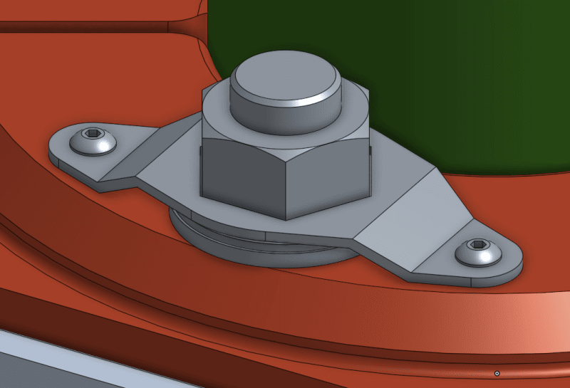

How about this:
Probably don't need 2 tabs if you want to simplify it...
Per your stated condtitions, replace the cap screws with welds...
I believe Im going to make a block with a milled slot (shaped like a U) with a hole in it for the bolt threads clearance. The nut is on the bottom side. A removable pin should keep it from wiggling its way out, but can be removed to replace the nut when required. We can always hope there is something off of the shelf, but usually you just have to make it.

If you can weld to the structure what about 1/8" x 1" strip cut to what ever length you need, then once the nut is tight put the edge of the strip against one of the flats on the nut and tack as required.
another option would be to have a thin plate plasma or water jet cut to make retainers with and 6 or 12 point ID shape (box end wrench profile) that can slipped over the nut (similar to SparWebs bracket) then tacked.
