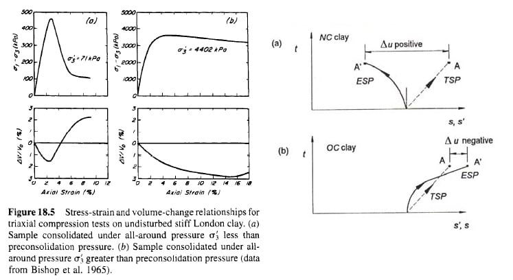

Just wanted to comment on Geopavetraffic and fattdad's point regarding drained failures of over consolidated clay and yes they do happen. In my experience which is predominantly on slightly over consolidated clays, construction always loads up clay into the normally consolidated range which exceeds the pre-consolidation pressure and generates positive pore pressures, which is illustrated by the figures below regarding the effective stress path and total stress path.
But that may not be the case here which may consider the case where the construction may be less than the pre-consolidation pressure. Which is why i endorse the previous comments of checking both drained and undrained failure conditions, with drained failures from the tedious reduction in friction angle.
