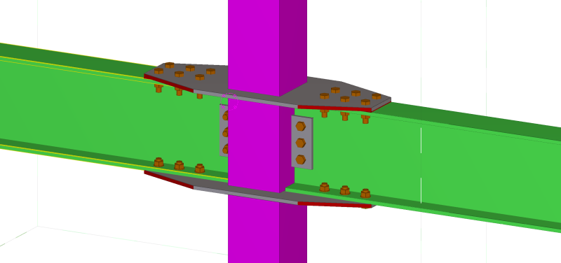

Local Buckling check of HSS column in Stub Connection
TekEngr
Feb 4, 2012
148
How I can check the local buckling capacity of the HSS square column in through plate stub connection any reference or example from American code.
Or any design procedure / example of this type of HSS stub connection from British code?
