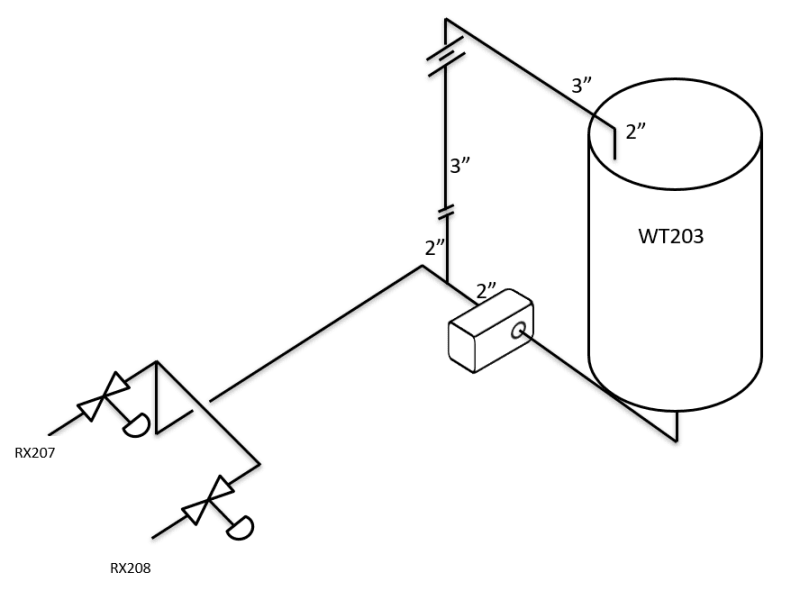

We are having a somewhat perplexing problem.
We have an emulsion polymerization system in which a monomer emulsion is created in one tank, then pumped over to atmospheric reactors at 120-200 F over a 3-4 hour period. The reactor and the emulsion tank are at equal elevations, with a lobe pump used as the means of conveyance between the two. A rupture disc is on the discharge side of the lobe pump, and recirculates back to the emulsion tank. Between the lobe pump and the reactor are a check valve and an automatic valve. The disc is set for 115 psig. The line and pump between the emulsion tank and reactor is 2", and typical flows are ~15 gpm. Viscosity of the emulsion can vary, and it is shear thinning, but usually 1-3,000 cP. These tanks are drawn until empty (drawing air), then are washed down with water to clear the emulsion tank.
We are having an intermittent issue: Sometimes when a batch is finishing and the tank is about to be washed down (or is being washed down), the rupture disc blows and recirculates material back to the tank.
To my mind, there are only two possible culprits here - the check valve and the automatic valve. Due to the repeated nature of this incident (and the timing of the failure), I suspect something wonky may be going on with the check valve. It is a swing-type check valve (a TCI TC-CKF, 2" 150#, to be specific). Is there something with swing check designs that can cause pressure spikes if the liquid flowing through it suddenly changes to air? All I can see is that the check valve may chatter a bit due to pressure fluctuations, but with only 7-8 psi static head due to liquid level in the reactor, there isn't much pressure to overcome.
Liquid Flow:
Tank -> Lobe Pump -> Check Valve -> Actuated Valve -> Reactor.
If the ABV and/or check valve close too quickly a pressure wave/spike could burst the RD. We don't use swing checks in emulsion service. It gets gummed up and acts erratically. Try a ball check. The transition from laminar (emulsion) to turbulent (water) can be very noisy in terms of pressure waves.

6. Ball and swing-check valves are the two checkvalves most likely to create the problems you describe. Change to soft-closing if available for the fluid. Spring- weight loaded swing-check might be suitable, correctly dimensioned. Costly but good.

All: Thanks for the responses. Maintenance took the system apart and found the swing checks to have a good amount of buildup on them. My guess is that this was enough to cause the check valve to occasionally stick closed when the pump was cycled. We have cleaned and replaced them for now, but will be replacing them with ball checks and put them on a cleaning PM. Latexman - we actually have ball checks on every other system, but somehow don't have it on these! I'll try to remember to update this in a few weeks if the issue disappears.

4. Sketch is attached. The check valves are right before the automatic valves, which are directly bolted to the reactors.

Okay, with the discharge line going over the top of the tank, backpressure on the RD is constant, so in principle, the selection of the RD is acceptable.
Agreed, a sticking check valve may be the cause of pressure spikes. Swing checks are also notorious for chattering at low flows. Wafer checks are better-they should be correctly oriented if you choose to opt for wafer checks.
With two control valves inline, any excess pressure in the line would be dissipated through either one partially one control valve, provided there is some excess pressure margin available (or if there is a gas filled dampener inline to absorb the transient pressure spike).

Thank you for all of the responses. It has now been 1 month since we took the check valves out for inspection. They were found to have significant buildup on them. They were cleaned and replaced (Latexman, we will be doing the MoC to transition to ball-type soon - we have ball-type checks everywhere else but on this system!). We also put the check valves on cleaning PM.
Since that cleaning and institution of the cleaning PM, there have been no instances of this occurring. This is sufficient for me to reasonably conclude that the check valve was indeed sticking and causing a deadhead scenario.
