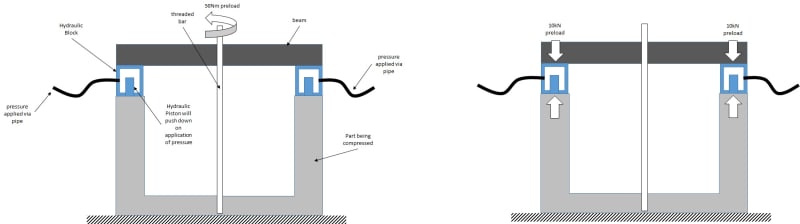

Hello,
I am currently working on a fixture which is essentially a beam with upward forces being applied at both its ends. The centre of the beam reacts the total load via a threaded bar which is grounded at its base. The previous derivative of the fixture required that the threaded bar be torqued to 50Nm prior to applying the external vertical forces.
The previous calculations did not account for this additional load due to the pretorque of 50Nm. Should it have been included and if so then should the classical lead screw method be used to evaluate the additional force due to 50Nm? And is it simply a matter of adding the external fore and the torque force to get the actual total load in the system? Please refer to the sketch to elaborate on the setup.

I believe that I have not clearly explained the setup. The external load application points are essentially interfacing with a hydraulics system. Thus first the bar will be pretorqued to its designated values of 50Nm. The resulting load due to the torque is reacted at the hydraulics interface point. Then the hydraulic system applies the external force.
The hydraulic interface is actually a hydraulic cylinder placed between the bottom face of the beam and another component which we are trying to push down. So I thought that the beam would firstly react the load due to torque via vertical reaction at the hydraulic interface. Then the external applied load will be introduced to the setup and hence add to the pre-existing interface loads. I am seeing it as two free body diagrams of a simply supported beam for two load sources. Thus, the accumulative effect would be the combination of the two?

Just a clarification that the 50Nm torque is not actually the required force but it has been stated in the instruction manual as part of setting up the assembly. So I guess it just seats the beam. The actual applied load is via the hydraulic interface which in turn pushes down on a circular ring. Thus the objective of the fixture is to actually push down on this ring via the hydraulic force. Therefore, the threaded rod is not actually applying the intended force but merely reacting the load in the beam as a result.
So my main question was to understand if the 50Nm preload needs to be added to the actual hydraulic load to get the total load in the setup. And based upon the other comments, I believe that it is the case.
And following from that question, I was trying to understand the application of the typical preload equation in scenarios where the joint is actually not a compression joint but two plates a certain distance apart i.e. the preload is dependant upon the bending stiffness of the plates, as opposed to the compression/bearing stiffness? My initial thoughts are that the resulting preload will be less than an equivalent compression joint. Or, have I misunderstood the equation T=F*k*D; is it simply implying that torque = friction x force x distance and has nothing to do with the nature of the joint?

HotRod10, after drawing the following sketch of my setup, I can make sense of what you were talking about earlier.
The hydraulic block region essentially behaves like a clamped joint where the 10kN preload due to the 50Nm torque needs to be overcome by the applied pressure in order for any further load to be exerted. Therefore, unless the applied pressure can overcome the 10kN preload then the structure only sees the preload. However, once the pressure overcomes the 10kN preload then the system only sees the applied pressure load. To summarise, the maximum load is the maximum of the preload and the applied pressure. Would you agree with my understanding?

Just so I can respond accurately, does the preload exert force on the hydraulic cylinder or some type of rigid block next to the hydraulic cylinder?
Hotrod10, the preload is applied on the casing of the hydraulic cylinder. Thus the pressure gauge will show zero pressure in the presence of only the preload due to the recessed design of the piston and load transfer via surface abutment. Hope that answers your question.
Yes, that is what I needed to know.
So, when the preload is applied, the casing will be in compression and support the load. As the pressure in the hydraulic cylinder is increased, the preload force will be transferred from the casing to fluid pressure in the hydraulic cylinder. When the pressure multiplied by the area of the cylinder reaches 10kN (assuming the casing to be rigid), the casing will be unloaded, and the hydraulic cylinder is carrying the 10kN. If the pressure increases, the pistons of the jacks go up, the beam bends, the threaded rod stretches, and the forces on the jacks and the rod increase. Once the beam is lifted off the casing, the force at the jacks is equal to the pressure multiplied by the cylinder cross-sectional area, regardless of the magnitude of the preload.
