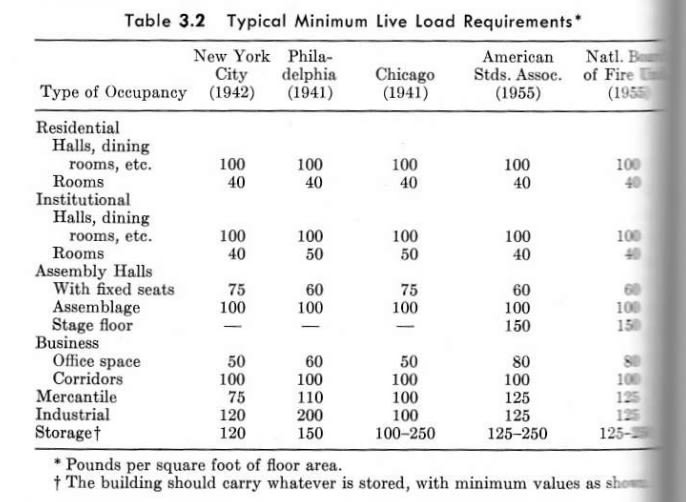

Not exactly on the topic, but adjacent at least, here's a live load table from Design in Structural Steel, Lothers, 1953 (archive.org).
Sorry guys I can't edit my previous post, the reference is wrong. This is from Structural Steel Design, Lambert Tall, chief editor, Lynn Beedle, and Ted Galambos, Fritz Engineering Laboratory, Ronald Press Company, New York, 1964. Page 50. I scanned it downstairs then decided what book it came from upstairs, because I kind of wasn't expecting to correctly guess the scanner buttons correctly in the dark.
