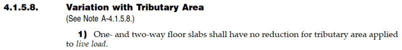

This doesn't really answer your question, however given that it is a thread on LLR I thought I'd put it here for future searches.
The 2020 NBCC has updated clause 4.1.5.8 to include that LLR may not be used for one-way and two-way floor slab systems.
Not sure if something similar is coming down the pipeline for the American codes.

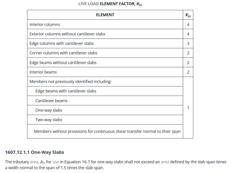

1 - using the lowest of the allowed live load reduction for beam, column, and slab, would be conservative, but as it's conservative, it's above code minimum. I'm not aware of a slab live load reduction, however. But a beam would typically have lesser influence area and a lower KLL factor so it will have a smaller live load reduction. The column is allowed to use a larger live load reduction due to larger influence area and/or KLL.
2 - this sounds like using the largest "allowed" live load reduction. That would be unconservative and would not meet code minimum.

Well, it looks like some measure of live load reduction to a one-way slab is allowed but there's extra stuff going on there, I must have just taken the KLL of 1 to mean there's no live load reduction permitted.
Source: Upcodes (Illinois building code, it's what showed up first).
If the alternate live load reduction is still in the code, that might be applicable to a one-way slab. And that may not allow larger reductions for the beam and column. Not that your average precast column is all that dependent on a live load reduction.

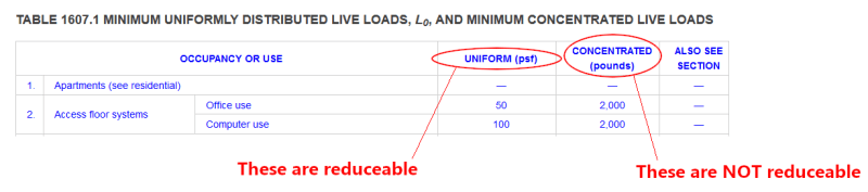

It simply doesnt make sense that having two concentrated loads on opposite ends of a one way slab would allow me to reduce the punching shear for each of the loads more than if I only had one.
Live load reduction only applies to uniform loads. You can't reduce concentrated loads.
IBC 2021 said:
"...members...are permitted to be designed for a reduced uniformly distributed live load, L..."
I don't agree with that interpretation. That would mean the only member you could reduce live loads for would be slabs. Every load on a column is concentrated. Beams are concentrating slab loads. I believe all they are trying to say is the uniform loads given in the tables can be reduced. A concentrated load (typically) originates as a distributed load somewhere.
I was not suggesting that uniform loads whose load path gathers them into a point load (like at beam end reactions) cannot be reduced. (They absolutely can. Table 1607.12.1 refers specifically to columns.) The concentrated loads that cannot be reduced are the loads that are applied as concentrated loads.
Got it, thanks for clarifying. In the hypothetical case being discussed, these loads originated as distributed area loads.
