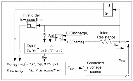

Bayview,
The internal impedance of a battery determines its health and its short circuit capability. A battery can be modeled by an ideal voltage source in series with its internal impedance (in your case 3.3Vnom with 8 mohm). So applying a short circuit to the terminals will result in a current of 3.3/0.008 = 412A (albeit briefly!). If comparing two similar batteries of different makes, the one with the lower internal impedance will be able to supply a greater current under short circuit conditions.
The internal impedance will reduce the voltage seen at the terminal of the battery due to a V = IR voltage drop WITHIN the battery (V terminal = V ideal - I x Rint ). Of course the impedance will increase as the battery ages and that is why an old car battery struggles to start a car. The internal resistance and therefore the internal voltage drop increases, resulting in a lower terminal voltage to drive the starter motor.
I would expect the internal impedance to also vary somewhat with the state of charge. If anything though, it should decrease as the state of charge increases, which would be consistent with a higher fault current expected from a fully charged battery.
So to answer your question, your calculations for R are not correct as they do not represent the battery model.
The block recommended for modeling a battery in mathworks is a more complicated version of
EnzoAus post above. Link
