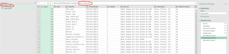

Step 1: Add an "index" column

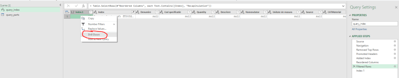

Step 2: Filter your relevant column by the term "Recapitulation". This should give you only one row.

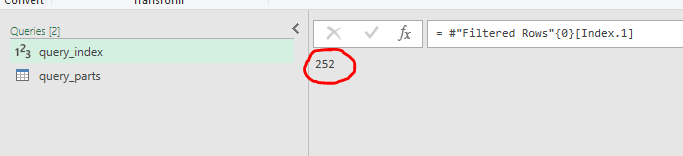

Step 3: RMB on that number in the index column and select "drill down" This will output that number as a value and you can use it in the next step.
Step 4: Duplicate the query and delete some steps. Finally you can filter top rows. Please see the formula bar and how to use the number from step 3. You need "+4" because you also have to filter some 4 preset rows where Catia writes some stuff.

1. Does the "query_index" need to be changed to the format that shows a 123 the the left of the title?
I was able to get all of this done and it seemed to perform correctly, but my "query_index" shows up just like the "query_parts" in your picture as a sheet.
