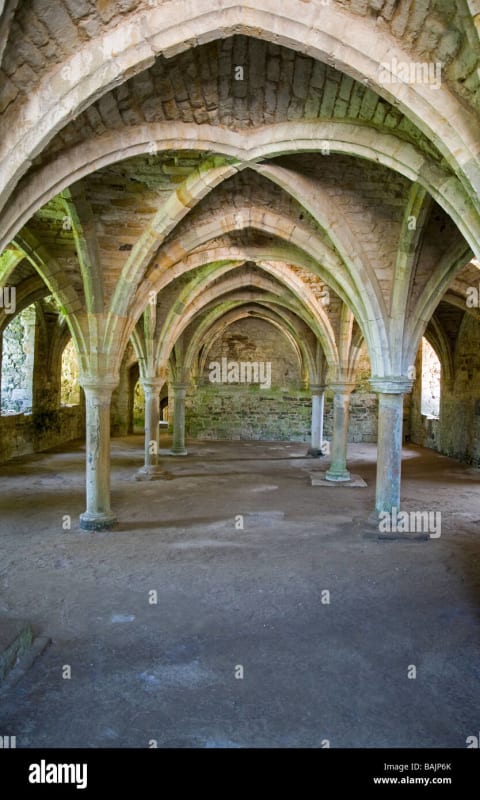

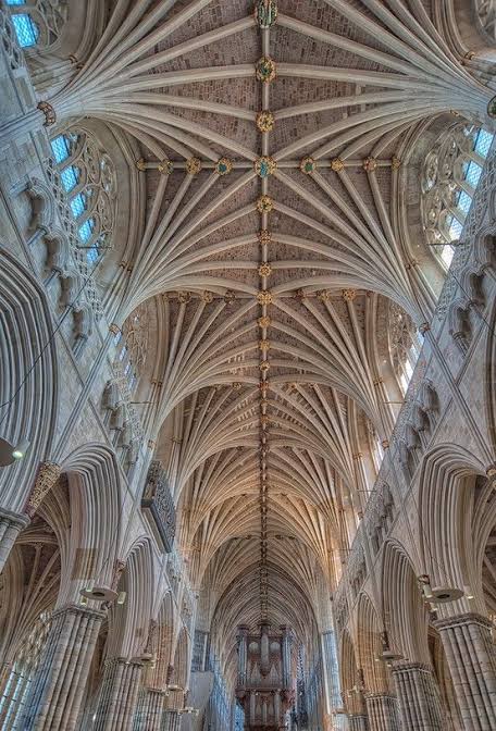

So true. We are so lame compared to those guys:
