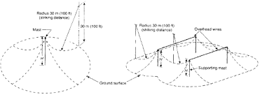

I've been told that a single lightning protection (franklin type) mast covers around 250 meters (800 ft). The total area under study is between 200 and 300 m2. Under which standard are these masts covered?
Thanks!
A single lightning mast of 20m (~60 ft) in height above of the target could cover approximatelly 300 m2 (3,220 ft2) .
ANSI/IEEE Market places:
SUBSTATION: IEEE 8O- IEEE Guide for Safety in AC Substation Grounding
BUILDING: NFPA 780: Standard for the Installation of Lightning Protection Systems.
NOTE: There are difference in the rolling sphere radius considered in both standards.

You can use IEEE 998 (Guide for Direct Lightning stoke shielding of Substations) as well for substation applications. It does discuss different methods like the fixed angle, empirical method, and electrogeometric model (rolling sphere method).
What are you protecting? Generally, it is less expensive to protect a building with air terminals (lightning rods) on the roof instead of masts around the building. Protecting an outdoor substation that way is difficult because there is no roof over the substation.
The area protected by a mast depends on the height of whatever it is that you are protecting.
