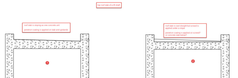

lift shaft roof slab detail (waterproofing)
lolobau
Dec 10, 2012
115
Hallo guys
I wonder what is the best detail for a lift shaft roof slab
should you provide the slope in the concrete or screed?
where at best should you provide the water proofing?
first of all I don't like the Architects required upstands.
Why shall I run this danger if the spout blocks and pond the water on the roof?
Provide the slope in the slab. A lift shaft is of limited size, so it is simple to accomplish. As to making sure the water has a way to escape, architects are often not accomplished drainage designers.
@hokie: you mean directly in the concrete and not in the screed?
I definitely prefer to slope the concrete directly
i agree but why do the most engineers and actually all Architects like to operate in such cases with screed?
That is not my experience. Why two operations when one will suffice?
