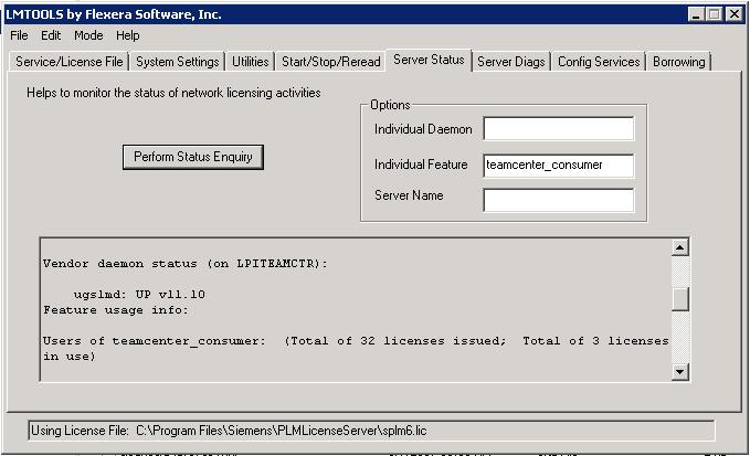

I am trying to see if some users are abusing the license Terms. I am checking by Company if the Guidelines are being Held. The Version of TC is: 10.
Running LMTOOLS on the server can give you some information, too.
You can enter the Individual Feature (as called out on your license file) and it will return who/what/when on feature usage. Just a snapshot at time of Enquiry, but, could give you some idea of current usage. Worth exploring.

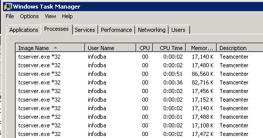

...and what of the 'warm processes' that are initiated on the server? Do they also consume a license at this point? or not until someone actually logs into TC. Once a process is allocated to a user, I understand it will remain assigned to that user until it times out (3-4 hrs?) of not being logged in. It would have to be asked of someone more knowledgeable if the license is also kept 'warm' during this time.
Just something else to think about...
