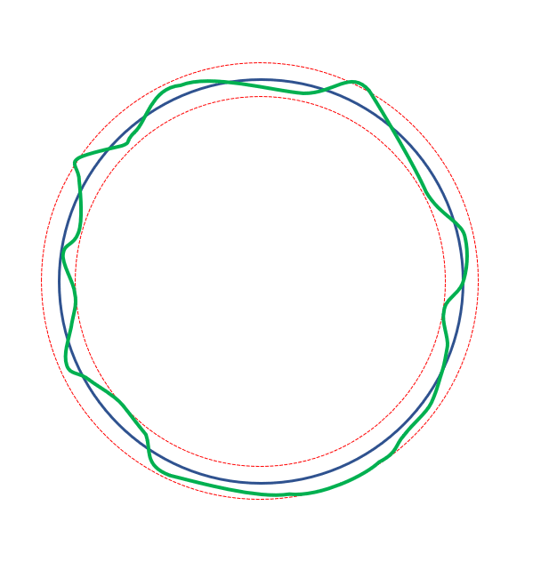

Hi pmarc
If I interpret the GG tolerance in cross section . See image below. The blue line is Ø51.05 and the dashed line is the plus and minus tolerance (51.05+0.5 and 51.05-0.04)
The green line is the GG tolerance which is whitin the upper and lower tolerance. It should not go outside the tolerance limits. Have i understood this correctly?

I don't see a GG circle in your sketch. If we assume that the green line is the actual/extracted contour of the feature in the cross-section, a GG circle would be a least-squares circle derived from it and the diameter of that circle would have to be within the 51.01-51.10 limits.
Notice that that a GG circle falling within the size limits might be established from the actual contour similar to the one you drawn, but it might as well be established from an actual feature which would be... a square, as an example. This is why a circularity tolerance is needed.

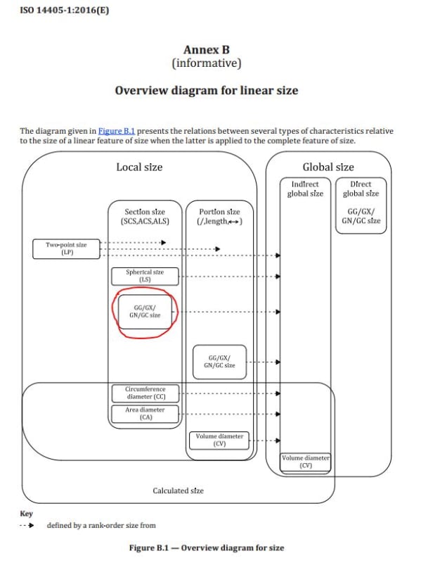

Per Table 3 in ISO 144405-1:2016, the GG+SCS specification is a "local size with least squares association criterion". Figure 29 in the standard shows a very similar example to the one posted by naah.

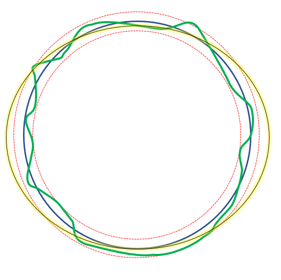

Hi Pmarc
I have updated the sketch with the GG counters See the yellow line in the image below. As I understood the GG circle could be outside the +- tolerances.
Is it correct that the average of GG value should not exite the nomnial diamter value?

I am not pmarc and I am sure he will come with additional explanation, but I would like to say that my understanding is that the GG circle should be within 51.01- 51.10....as pmarc stated: " a GG circle would be a least-squares circle derived from it and the diameter of that circle would have to be within the 51.01 - 51.09 limits."
By the way, why you removed the initial / original specification? Do you have any reason(s)?

I am not sure where all these conclusions are coming from. The direct global size has its definition in ISO 14405-1 and purpose. I would have to paste a solid chunk of standard to explain this. Instead, here is a snapshot of Annex B to the standard on which I marked how the size specification originally provided by OP fits in the global scheme of things.

As far as I see, the yellow line in your picture is still not a circle, but rather an oval/ellipse. Circle, by definition, is perfectly round.
The specification you had in your original post basically says that once you establish the least-squares circles from the actual contour in cross-sections D, E, and F (a single circle per cross-section), the diameters of the circles must fall within the 51.01-51.10 range.

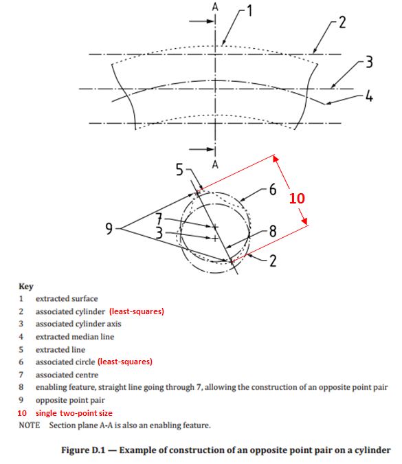

The attached picture comes from ISO 14405-1:2016 Annex D and its original version explains the construction of an opposed pair of points on a cylindrical feature. To help discuss different cases here, I have added a few features (in red) to the figure:
1. If the size specification is ∅50 ±0.1 only, this means that all two-point sizes labelled 10 must be within the 49.9-50.1 range. This is a default interpretation of size specification in ISO GPS.
2. If the size specification is ∅50 ±0.1 (GG), this means that the diameter of the cylinder labelled 2 must be within the 49.9-50.1 range.
3. If the size specification is ∅50 ±0.1 (GG) SCS, this means that the diameter of the circle labelled 6 at a specific cross-section must be within the 49.9-50.1 range.
4. If the size specification is ∅50 ±0.1 (GG) ACS, this means that the diameter of the circle labelled 6 at any cross-section must be within the 49.9-50.1 range.
All 4 scenarios allow for different things to happen with the as-produced cylindrical feature and definitely all 4 require additional geometric controls to be able to say that the feature has been fully defined in terms of its size and form.
The first point (1) I would like to clarify just a little more: the distance between two opposite points in a cross section perpendicular to the axis of the associated cylinder (the cross section centers should be on the associated cylider axis).
Then, in my understaning, BY DEFAULT, this associated cylinder (number #2 in your sketch) has the association criterion as the total least square algorithm.
So, I concluded that the total least square is the default for the two point size.
Looks like you don't disagree with my above conclusions. Don't you?
(But I fully agree with you that I have some FUNDAMENTAL missunderstandings of the ISO GPS)
greenimi,
The total least-squares cylinder is an associated feature that is the same in all 4 cases that I described. So yes, it is a kind of default.
