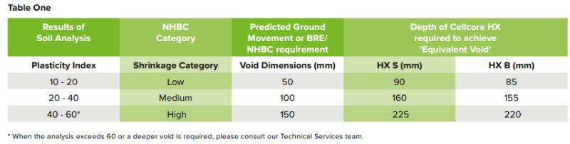

With a plasticity index of 19%, you are just in the low volumne change potential, based on BRE 1993a. (The UK standard method for assessing expansive soil risk). Furthermore, if you use the modified PI, which is based on the percentage of fines, you may have a lower PI, but only slight I suspect.
In the UK it is common to found footings that take structural loads on non expansive soils so at several feet deep and then support your slab on grade. Beneath your slab you would include a void former (essentially some load bearing expanded polystyrene that can support the slab load, however if there is any swelling pressure from beneath, the void former can compress and relieve the expansive forces). You are in the low category, just barely, which indicates you do not actually need a void former. However you could adopt the recommendations for medium expansive soil risk (PI 20-40), which estimates 25mm of expansive and therefore requires a void former of 50mm in thickness. See below info from a supplier:
GeoEnvGuy - I wouldnt recommend Option 3, if anything, an increase in structural load would be recommended to counteract the upward expansive pressures. If you excavate material, say 0.5m to remove your slab load of 10kPa (assuming a unit weight of 20kn/m3), you have to backfill with something. If you use well compacted granular material, the expansive pressures may still be transferred to the slab. However, in saying that, if you remove enough expansive soil and replace with well compacted granular material, any expansive forces from beneath could be "lost" within the compacted material.
