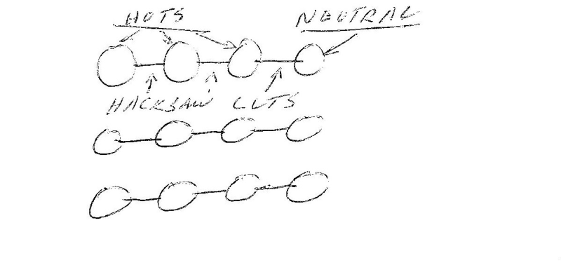

"The conduit box for alternator is found with steel plate and the plate is magnetizing." - This matters if the cables are single core cables and the impact will be overheating of the gland plate.
I have seen steel plate used with single core cables but there is a break created in the flux path around each cable by making a cut in the gland plate and filling it with brass (non-magnetic material).

This has always solved problems for me and avoided problems.
Your problem may be from the heat generated by the magnetic encirclement.
Use non magnetic connectors or glands.
Each group of three phases and a neutral must pass through the same hole.
This is a lot quicker and cheaper than fitting an aluminum or stainless steel gland plate.
With the hacksaw cuts between the cable entry holes, the flux sees it as one odd shaped hole.
I have seen a 400 Amp disconnect switch destroyed by the heat from magnetic encirclement with a maximum load of less than 200 Amps.
The heat was generated in the steel and was conducted by the cables to the switch hardware.
The owner told me that the switch had been replaced several time due to heat corrosion.
In another facility I have seen breakers trip because of the heat generated by magnetic encirclement and conducted to the breaker by the conductors.
